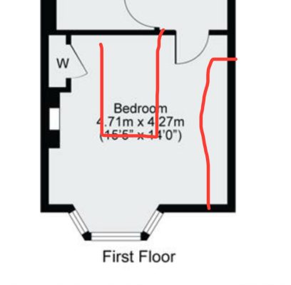

    I’ve recently completed on a Victorian semi detached renovation project and have applied for planning permission for a small ground floor side return extension. This has ruffled the feathers of my neighbour who has apparently lived in the house for 35+ years. He’s put on objections which my architect has said aren’t on the permitted grounds to reject an application, but all noted.
    In the interest of neighbourly relations I’ve now attended several meetings that he’s requested to go over my plans.
    One that he’s asked for is soundproofing my bedroom wall, as it joins his. Given the construction of the property and the period features in the house I’m reluctant to do so.
    i was originally going to have my bed on that wall (right side) but the comments he’s made have really put me off him being apparently able to hear me.. snoring..
    I’m thinking of putting my bed at the back (see rubbish mark up of floor plan) and then doing a row of built in wardrobes on that wall to try and act as a sound barrier. It’s not my ideal layout as original plan was to build on wardrobes to the alcoves around the fireplace, but I really don’t like the idea of him being able to hear everything that goes on in my room. The extra storage wouldn’t hurt though!
    It will be carpeted as well, so hopefully that should assist. The cupboard on the existing plan will be removed and I’ll probably put some shelves up and an armchair in one of the alcoves.
    Does anyone have any suggestions on layout generally, or for anything that will help with soundproofing?

    He’ll probably be able to hear you because of the shared chimney breast – that’s where you both need to block and add some sound deadening plaster board

    I could also hear everything my neighbour did in their house next to ours via the Victorian walls, including when she went into labour! I actually did get some soundproofing, professional grade and it made a huge difference. So whilst understand he isn’t doing this to his side and probably just complaining for the sake of it – perhaps it’s worth considering? And then you can have the room layout you want?

    Now your situation, I can see it from both sides. We soundproofed the alcoves at great expense and it did nothing as the chimney was the weak spot for noise.
    I think your cupboard idea is probably a good one as it will be filled with clothes to hopefully muffle the noise. Fun and games in the world of renovations! It’s a shame we have to step in so much with our extension but I can’t risk building too close to nextdoor as they are also a lively family. At the moment we can’t hear each other and that’s how I wish it to stay.

    I’d always add sound insulation on a shared wall if I had the opportunity to, especially in bedrooms. If he’s asking about it, he knows a thing or two about how thin the walls are. Consider joists carrying sound too, I believe they can if laid a particular way. I had my bed in your planned position, I loved it, could sit in bed and look out the window. I’m also fairly sure it’ll add some value to the house.

    We have this layout in our Victorian and the wardrobes are a good soundproofing option. Our neighbours have never heard our babies screaming, so try this. He sounds a tricky one. I’d tell him you are adding soundproofing and just do the wardrobes and I bet that will satisfy him

    I have the same Victorian bedroom. Storage was important to me so I put wardrobes all across the chimney breast wall (including in front of the chimney breast where the shelves are deep enough for folded clothes as opposed to rails) and my headboard is against the internal wall. And I flipped the bedroom door hinge so it swings the other way. But I think your idea to have the headboard on the adjoining wall is also lovely and a popular choice. I don’t see why you should compromise because of your neighbour’s unreasonable requests. Unless the council requests you to do something, to stay neighbourly I would smile and say that’s a great idea and then who’s to tell whether you actually put the insulation or not. Frankly it’s none of his business. Ask the builders strictly not to let anyone in the house if you’re not there during the reno, because nosy neighbours tend to try their luck.

    Is this room already adjoining his? I’d be wary of capitulating- can you hear him already? He can’t really be asking you to change the original part of the house just because you’re extending. Sadly, it’s often those who have lived there the longest who seem to think they control the neighbourhood. But if you are doing anything in that room, you could install rockwool sound insulation between the joists which is always a good thing anyway (and won’t interfere with the features). I’d also be prepared for him to demand pw surveyors etc as there won’t be any appeasing him no matter how considerate you are
