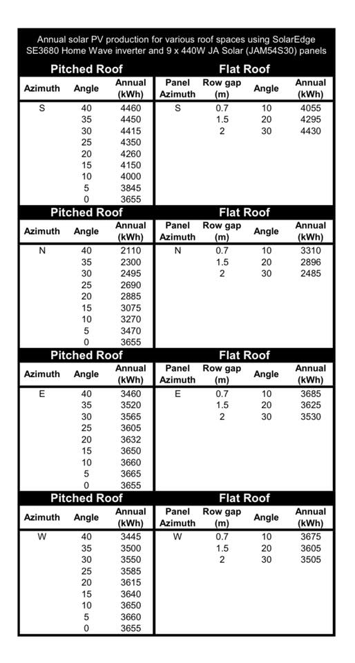

    The generation is 50% of South roof, 4000kwh south then approx 2000kwh north, big cost is probably the scaffolding. Pvgis will do you calculations on yield based on your location.
    • Phillip Boyd
      April 26, 2026 at 9:38 am
      yeah so 4457 south last year. so about 2.2k north, or £264/year worth of export at 12p/kWh. at 10 years looking at an install cost of around 2.6k to even bother by sounds of it.

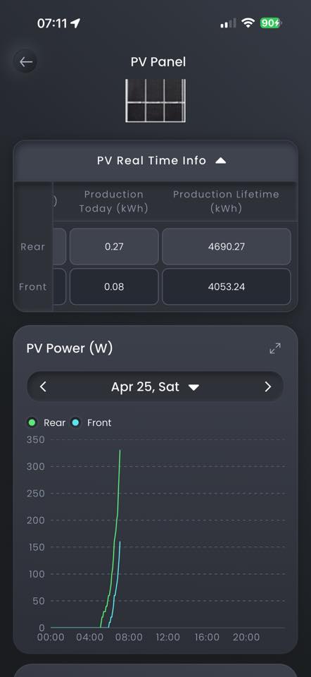

  • Robert Wilson
    April 26, 2026 at 9:45 am
    You make the call but here is my numbers. Personally yes.
    I’m 637kwh ahead on the rears which are north vs the front but they are becoming more and more alive as the suns position is different and longer duration of generation as well as earlier.
    Total capacity of 9.34 kWp (19 Panels)
    Rear 6,120 kWh
    12 × 510 Wp AIKO Neostar 2S solar panels (North Facing, 313* NW)
    Front 3,220 kWh
    7 × 460 Wp AIKO Neostar 2S solar panels (South Facing, 146* SE)

    Think about what you generate on the non-peak production times of the year when you actually want more energy. That extra capacity makes a noticeable difference and rather than being 50% less its nearer 20/30% even though production is lower
  • Steve Pennison
    April 26, 2026 at 9:50 am
    As others have said, use pvgis to calc production; slope makes a big difference. Mine was calculated at 60% of an equivalent south facing array. Need to calculate cost versus production value, as per any install, and decide if the ROI is acceptable to you. I’m in the same situation and as yet undecided
