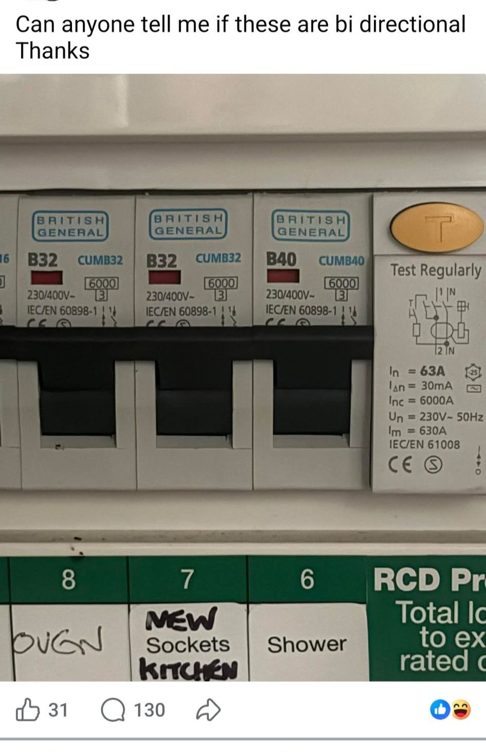

    This is a brilliant example of why plug in solar is going to be a problem, they are back feeding a ring main, with protective devices that arnt suitable to be used with solar/DC generating equipment. There’s more to think about with electrics and solar than just “will it work”
    For context, the RCD isn’t bi-directional, so will only trip on an earth fault on the incoming direction, not if it’s back fed.
    It’s also the wrong type rating to be used where there could be DC injection on the system.

      most RCBO’S in domestic properties are not suitable for Solar anyway.
