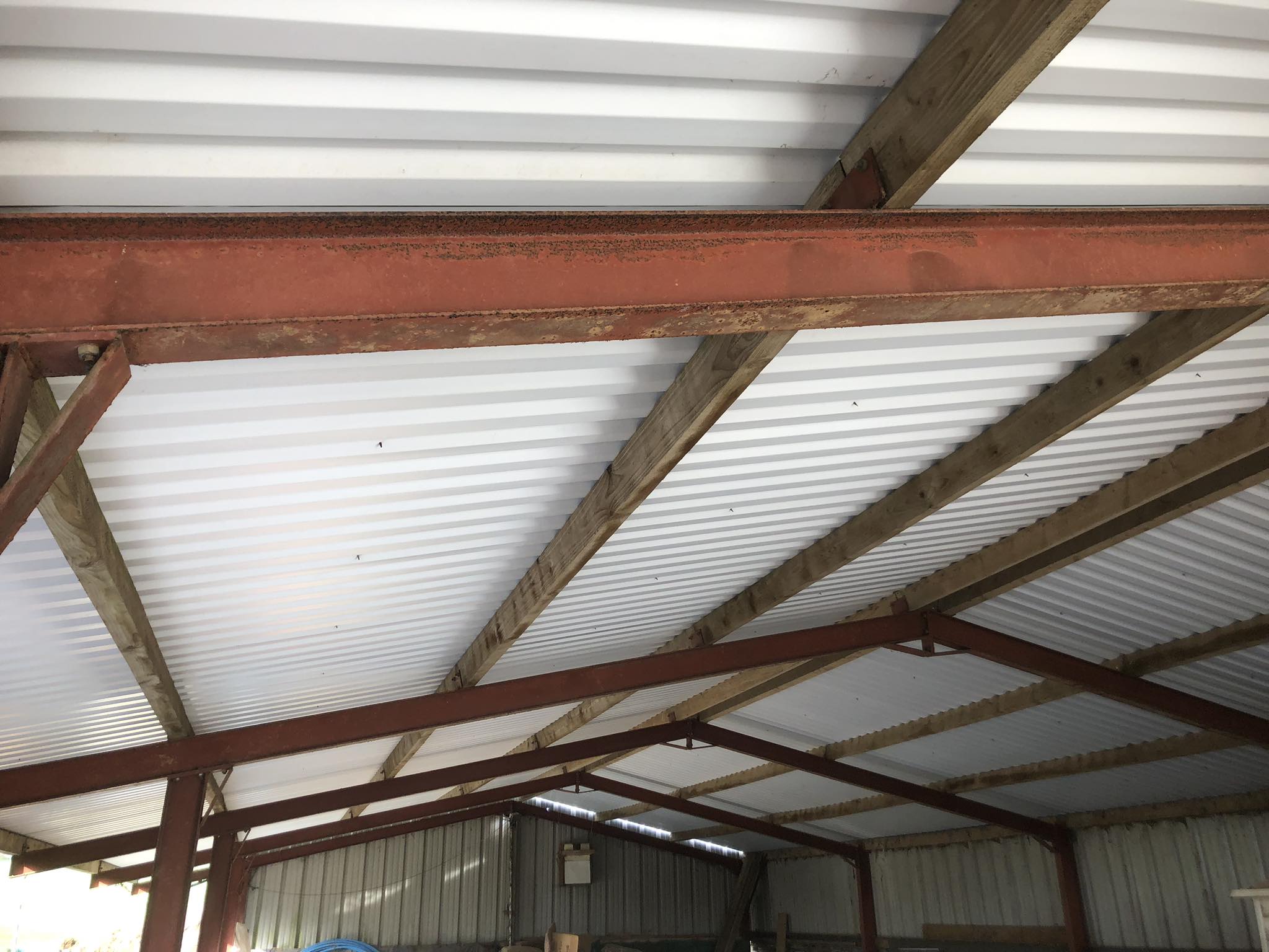

    Looking to have some panels installed, on the roof of a steel portal framed barn, believe using K2 fixings, for a domestic 3 phase off grid system. They estimate it’ll be a 13% load increase across the roof. My preferred installer is requesting we have a structural survey done on the barn first, I’ve not heard of them being done on house roofs ect before but could well be wrong, is this something people would expect to need? I understand it’s to cover them if it were to collapse ect but is that not my responsibility? Just thought I’d question it as the survey isn’t going to be cheap.

    We install onto barns regularly, it is common practice to do a structural survey, we have in-house expertise for that though. The design should aim to place the loading on the steel portals not the wooden purlins.

    it’s wise….the corrugated steel sheets are thin and designed for basic wind and snow loads….adding panels significantly increases the loads….. fixing to often 0.6mm thick steel is also of concern for fixings pull out etc…..get it checked.
    They will run a wind load calc for your specifics and spanability of sheets/ purlins etc

    Metasole plates would be ideal, the panels sit ~10mm from the roof, this reduces wind loading and the need for rails if the tin is thick enough. The panel weight is negligible and perhaps if you know the company who done the steel frame they can comment on the loading allowances.

    That roof does look pretty “light” to me…I’d be inclined to some intermediate purlins in

    That roof looks pretty standard to me. My own and 2 friend’s installations were on very similar roofs.
    Renusol MS+ mounts or the similar ones from Clenergy are great on trapezoidal steel roofs.

    We are looking at putting panels on a barn roof that is FAR more substantial than that, and the installed wants a structural survey done (arse covering exercise I suspect). That does look like a light roof to be fair.
