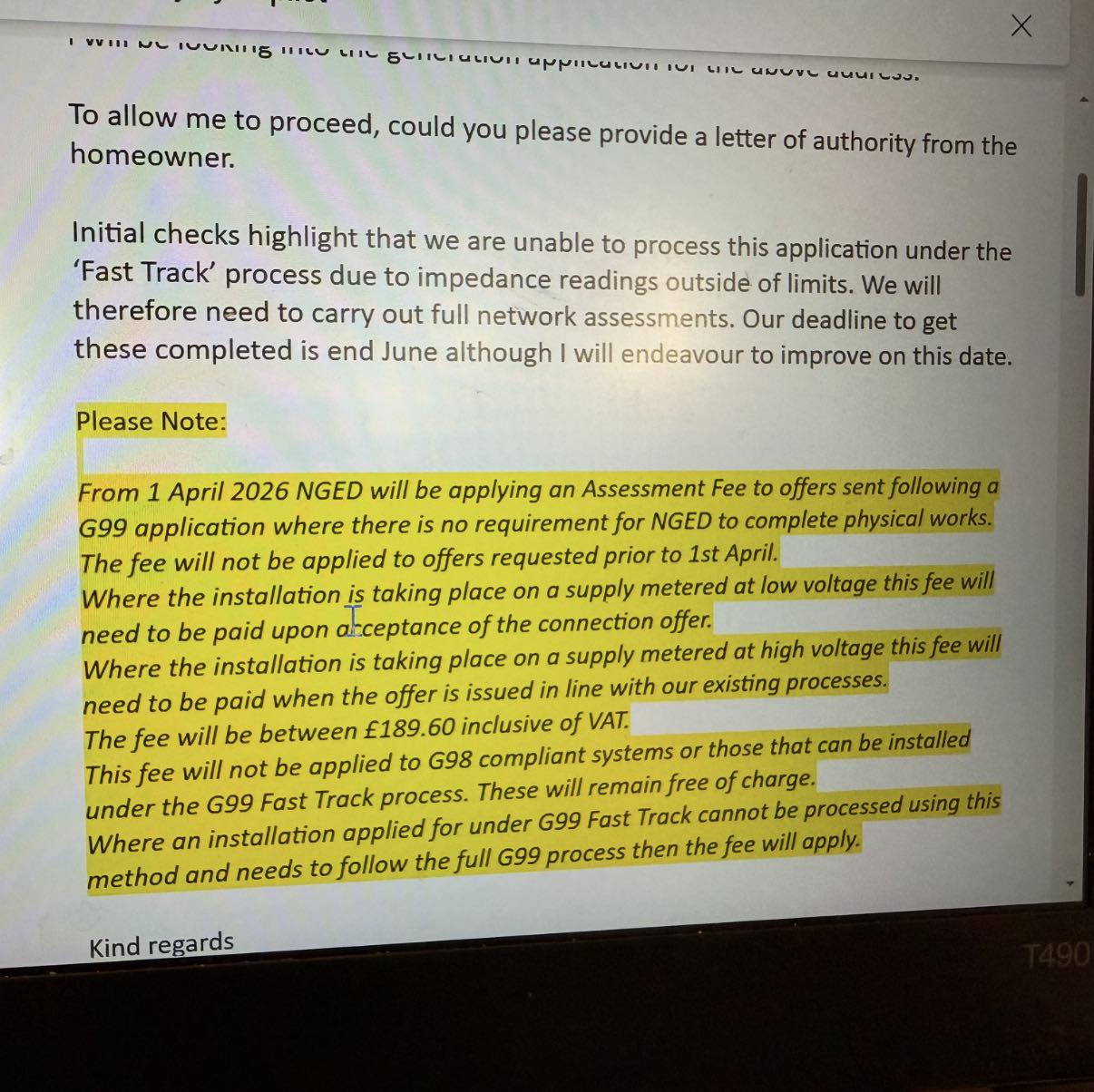

    I wanted to share one of our current projects and the response from the National Grid, this application is for a 6kW inverter, no other inverters at the property so generalising this should always come under the fast track route.
    However as you can see in the response, due to the infrastructure around the area we are looking to install, fast track is not an option.
    These things do happen and we will be liaising with the customer and DNO for an outcome that will work for both parties.
    Just wanted to highlight to everyone that assumptions really shouldn’t be made before installation and for those considering solar to ensure your chosen installer is getting the permission (if applicable) to fit before they install.

    This is awful practice by NGED.
    They specifically state that the issue is that the existing grid is operating outside of their self-determined limits… but instead of fixing that issue at their cost, they want to undertake an assessment to see if they can ignore the issue for now and charge you for the pleasure.

    The fee will be between £189.60 inc vat and what ??

    Interestingly since the 1st April NGED now charge £190 fee for any full G99 application and and G99 SGI 1, 2 or 3 that fails the fast track assessment on earth loop impedance and has to be progressed to full G99 with network studies.
    I contacted and chatted with 3 long term NGED planners I have been dealing with over the last 2-3 years to get the full picture.
    As such I have now altered our quote policy that any G99 system quote for any DNO has a £200 fee added to the quote, just in case.
