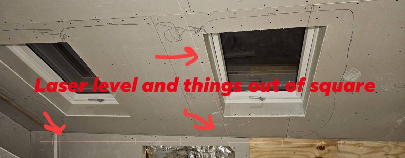

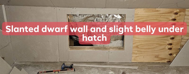

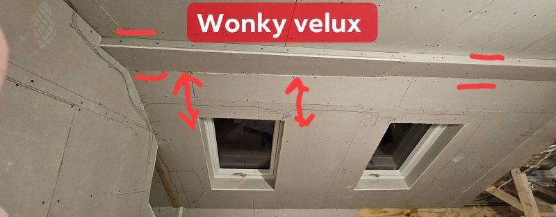

    1) Geometry issues: The velux window near the party wall is slanted and not square. With a laser level you can see how off it is. It looks horrible to me. The angles where the rafters meet the ridge are different at the party wall when compared to the gable end. The dwarf wall is slightly bellied and also slanting (as per pic). The builder says its minimal and picky… and that the plasterer will sort it. I’m not happy though. I’ve had to change our LED design to now not go around the reveals to highlight the problem. See pics.

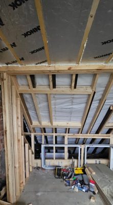

    Most of those problems are coming from the pre existing rafters.

    I’ve seen better and I’ve seen worse. It’s not uncommon for the original roof to be bowed, I’ve jacked them up if they have been really bad. It’s not always possible to get everything level and square on an old roof.

    Your not going to be able to tell 100% till plastered and a good plaster will be able to bead out to a degree

    That should’ve had a complete reroof really, the rafters and purlins are way out. Doing any interior finishing on a pitched roof if thats not flat consistent angles is nigh on impossible

    There limitations to what you can achieve with existing structure
    When your setting out your velux openings you don’t have the luxury of a throwing a laser on from the inside even the your going of existing structure so you’ll have compromises
    Its easy at the boarding stage to start nitpicking over 5 or 10 mm that’s never going to be seen after plaster

    Did they install new rafters or are these the existing old 4×2 roof
    Looks like old wonky roof stayed in place , super quilt over and slap boom
    • Charles Parker
      February 5, 2026 at 12:59 pm
      this is a pic mate where you can see some existing rafters… also I did all the insulation and superquilt… and I did it really good to expanding foam any gaps and spent £150 in aluminium tape lol

    Im a builder and think this job could be better but not the end of the world.
    If you say to the plaster if hes good at his job he can use bonding first to take out most of the issues before skimming. It will never be perfect but will only be noticed by yourself and anyone looking at the room won’t notice especially if painted all in the same colour

    Why didn’t you pack the timbers out before boarding. You have to put up with bowed existing rafters, but you square them with firings and packing out straight
    Plus the boarding on the ridge is shocking..one side is in to the board and the other is over.
    Don’t wait for it to be plastered find a decent chippy/boarder to square it all up by packing and trimming
