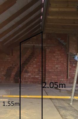

    Velux above the stair well and /or a staircase with a top landing then one step up from the landing into the room. you need two meters head room but it can slope away to 1.8meters at the side

    Use celetex allowing 50mm behind for airflow and superquilt stapled onto rafter with 20mm counter batten and 12.5mm plasterboard best you’ll get

    Is the ridge beam steel set above the existing ridge or just below the top of the apex ?
    If its just below to top of the apex of the existing roofline then its your floor joist that has been installed to high

    So easy to check the head room dimensions from plan view up onto the side section of the roof using cad, SketchUp etc (whatever the preference)
    They usually state if in doubt ask… builder has likely take the easy option in the floor and gone over the top of everything , summer beams etc without having the foresight to the end result of the stairs being to tight.
    This is why a loft specialist is always advisable , that’s said a few lads who used to work for me set up and have already folded so make sure you always get the company
    Possibly a VELUX Over the stairs would help
    Put the plan on here , may help could reduce the top of the stairs winder bringing the right side over
    Also , may sound ridiculous but use a laser level line to measure the head room.
    Quite often if the tape runs out of level it can add or reduce a few cms, all adds up in a loft conversion

    Velux would give you more hight. Might still not be enough to fully comply over full width of stair. But there is also a rule of centre going line.
    If it’s pitched ceiling for loft conversion only the center going must be 1.9m bellow the ceiling.

    Speak with the building inspector, there may be a compromise as the stair will still be better than a compliant ‘ships ladder’ access or alternating tread stair. A velux would probably give enough headroom for a compromise. Remember the diagram is only ‘guidance’ not law.

    Thanks all for your comments, building inspector will be out to advise and assess with a drop landing and velux
