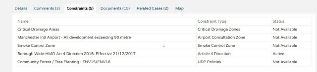

    it shows these constraints (screenshot attached). Does it suggest anything not permitted? I am looking to convert it only if it’s permitted development. Please advise if anyone has any knowledge about it? Thanks.

    Screenshot:
