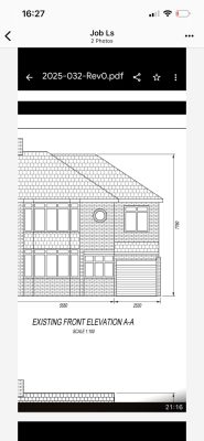

    Is there any one on here that understands planning rules properly, I’ve been doing lofts for nearly 23 years now and we’ve come across a massive issue from the council, they are saying because the house has a double story side extension which is set back 800mm from the main house the council has said the customer can’t have a hip to gable because they are coming past the principal elevation on the front part of the extension which I have never heard of this rule being applied it’s always been you cat come past the original house elevation??

    It’s not a house on a corner is it? Where they might be arguing the PE is on the ‘side’ of the house? Plans or photos might help.

      it’s the front hipped roof there saying we can’t change to a gable, which mean you can’t take the dormer across

    I believe the new principle elevation is now at the 800mm step back of the extension. This means you can’t bring the dormer to full planning as it will exceed it by 800mm if you drop it on the inner leaf of the existing house.
    Your architect should be able to redesign the loft so it lands on the extension inner leaf but you might have trouble with the foundations of the newer extension not being deep enough.
    It sounds extremely problematic but I would suggest going down the preplanning route before applying again.

      it’s the front where it steps in
      Dormer is at the back, also how does the new extension take the new principle elevation? Surely it’s the furthest part of the building on the house.

      Sorry I should have said you can’t use permitted development you’ll have to go full planning.
      Unfortunately it’s very technical wording but put very simply the new extension is the new principle. That 800mm faces the highway and everything will be decided from that, so you’ll have to do a preplanning application to see how much they would allow and then submit a full planning application.

    Hopefully this can help. The PD to do a hip to gable only applies to the original house, not the side extension, so you should be able to hip2gable the orginal roof, but no more. There is no PD above the side extension.
