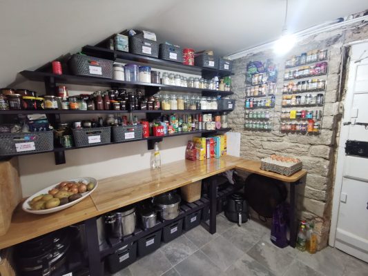

    Here’s ours. We have open shelves for large saucepans and appliances beneath the work top.
    We have matching baskets with labels for all the leftovers that don’t fit into the jars. The jars are all coffee jars with labels on.
    I particularly love the spice jar racks which we got on eBay. You can add as few or as many as you need. We’re UK based…we buy all our spice jars from Sainsbury’s so they match.
    I wish we had put in sockets for the appliances and a small sink.
