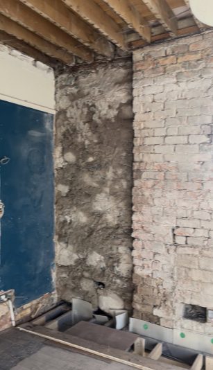

Posted by Winona Grey on March 17, 2026 at 10:53 amHi, I was hoping for some advice. We recently bought an 1901 stone built house. The survey uncovered significant penetration damp issues and consequently structural issues. We proceeded with the sale and have hired damp specialists. The house was originally pointed in lime but the previous owners repointed it in cement and then applied Thompson’s waterproof seal spray to the outside which has significantly contributed to the issues. Our specialists have said we should strip back the walls to the stone and put permaseal membrane on top. Then on the outside when the Thompson’s seal wears off, put stormdry cream on. All joists will be repaired and wrapped in a waterproof membrane. The damp is on every external wall in the house. Images attached. Is this the right advice?? It’s so much money to get it wrong.

That gable wall stone work looks saturated on most of the surface area, that’s probably due to it being coated in Thompson water seal, also looks suspiciously like it could be pointed in cement, the internal plaster work looks like it’s gypsum, so at an educated guess the walls are basically holding water and not vapour permeable, that’s the first course of remedial action if this is the case so the external/internal walls can dry out & be restored back to the original material it was built with.
Also looks like two of those walls in the image are close to the chimney breast/stacks so again I suspect you’d probably need to check the top of the flaunching on the stacks, cracked pots & make sure they have sufficient weather cowls or aren’t capped & also the pointing & lead flashings aren’t missing or failed, you’ll probably need some drone footage of the roof, could even be blocked or failed lead back gutters that need maintenance or replacement.
