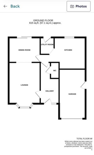

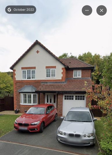

    Hi all, looking for a bit of advice.
    I’m considering converting my garage into a playroom. It would mainly be used for my wife’s childminding business, so it needs to be a safe, warm, usable space for kids during the day.
    The garage is attached to the house but doesn’t have internal access, and we’re not planning to add one. I’ve attached a photo of the house and the floor plan for context.
    I’m trying to get my head around:
    • Whether building regs will definitely be required in this situation
    • Anything specific I should consider because it’s for childminding (safety, inspections etc.)
    • Rough costs people have paid for similar setups
    • Anything you wish you’d done differently
    Planning to get a builder out to quote, but thought I’d ask here first to get a bit of guidance.
    Location Llandudno North Wales.
    Thanks in advance

  • Rich Murray
    March 21, 2026 at 8:29 pm
    Are you planning on getting drawings done?
  • Rob Falconer
    Building Controll 100% required.
    Planning would also be in my opinion as change of use to a public visiting business, it’s not necessarily the garage conversion that would require planning but as say Change of Use to a business.
  • Richard Ward
    March 21, 2026 at 8:30 pm
    i would do a doorway off the hall thats normal then it will feel like a normal room and you will need building regulations incase u ever want to sell the house
    • Michael Watkin
      March 21, 2026 at 8:31 pm
      unfortunately not possible stairs going up there.
      My plan was to build a porch to the front of the property and gain access that way.
  • Rob Johnson
    March 21, 2026 at 8:33 pm
    Why wouldn’t you add access from the hallway? . It will still be subject to building control and budget anything from £10-20k
    Edit. Seen your comment on the porch. That makes sense
  • Richard Harris
    March 21, 2026 at 8:34 pm
    It will need access to a WC
  • Ron Glegg
    I thought authorities check the house as a whole is suitable, surely you’re not looking to keep children completely seperate from the rest of the house and confine them to a small area?
  • Roger Ellis
    March 21, 2026 at 8:35 pm
    Building regulations will be necessary covering means of escape and heating as a minimum. Planning needs investigating first with your local authority. It may be permitted without a full application based on the business model you have in mind
  • Samuel Roberts
    We have just converted our garage and our house looks similar to yours. We did have to do a building regs application. It cost approximately £13,500 in total. We did have expensive LVT laid and a media wall built included within that price. We had a door to the side and an internal door right by the WC which I assume you could do too especially as you are using your space for childminding. We are in Kent.
