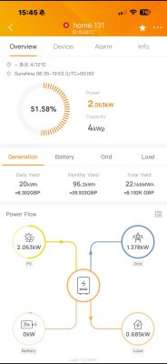

    Really don’t understand why my solar generated electricity goes to the grid (get paid very little but it by Octopus) instead of first charging my batteries.
    I have overnight charging set up to benefit for cheap overnight rates, 11.30pm to 5.30am (Octopus GO) but would also like to keep all my solar generated power.
    I have a Solis 3.6kw inverter, 7kw of Pylontech batteries 4kwp of panels.
    With power rates likely to increase substantially I really want to know I’m getting the best possible from my array.

    Will likely be your settings. under grid connection type what do you have it set to ?

    With my fox I can decide if excess solar goes to grid or battery. Currently all going to grid battery low

    You can set it up using EMS – I’m waiting for my G99 to come through (10 weeks now) so have told it to prioritise battery

    Also the icon at the top is red which means there is an error with your system. I would say the battery is off or below minimum SOC

    Itll be a setting… unless your battery is already full.

    it looks like you have an alarm fault showing on the app. Go to the Alarms tab and see what it says

    Solis inverter needs changing to Self Use mode, you will have it currently set to Feed In. Go to inverter settings on the app to change.
  • Luke Sills
    April 9, 2026 at 6:15 pm
    Which mode is the inverter in? If its an S5 just look on the front screen at the top. Its mostly likely that its in feedin priority, multiple modes are configured at the same time or a meter issue.

    I think mine goes to the grid when my battery is full.

    Mine was doing this- I changed the settings in Inverter Control>GRID FEED IN POWER LIMIT and put it to 0. Seems to have worked

    Priority should be solar battery utility under storage/advanced setting, observe for any changes. If still an issue, then limit the export to between 300-600W (not zero!). It should work.
