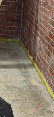

    The height of the DPM upstand / DPC could well be correct if that matches the finished floor level.
    If the concrete slab in the photo is the finished floor level there is a problem
  • Michael Cox
    December 24, 2025 at 10:27 am
    If that’s just the concrete oversight and there is insulation and screed going on top it’s probably too high if anything
  • Mircea Trif
    December 24, 2025 at 10:28 am
    Leave it in it’s your DPM and radon barrier
  • Dave Roberts
    Yellow dpm is usually a gas membrane, this is lapped into your dpc as a standard detail to prevent any chance of residual gas in the ground below the slab getting inside the room and preventing a potentially hazardous build up. This needs to be left intact and should not be drilled through or cut.
  • Donald Rogers
    December 24, 2025 at 10:29 am
    About 15/20 years ago this was the norm , designed to keep any fuel spoilage from entering the cavity, less so nowadays as cavity trays are fitted were a garage is connected to a property
  • Donna Crich
    December 24, 2025 at 10:30 am
    Yes normally, you will find the floor level in your garage around 4 inches below your dpc on the property
