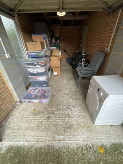

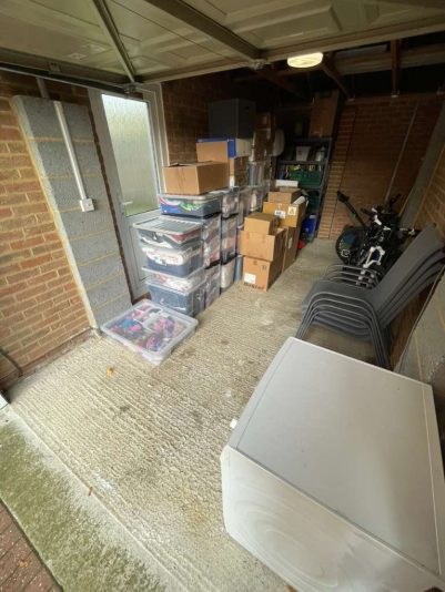

    I’m hoping to get some advice from those who’ve done this before or work in the trade.
    I’m planning to convert my garage into a small livable space before Christmas. The layout would include:
    • A single bedroom
    • A compact toilet room with a stacked washer/dryer inside (no shower)
    The garage already has electricity and the building itself is sturdy and in good shape, so I’m hoping that helps keep costs down.
    I’m based in Rochester, Kent, and I’m trying to get a realistic idea of what this might cost. I’ve had a few quotes already, but I’m getting conflicting advice on what’s included.
    Specifically, I’d love help understanding:
    • Do most contractors handle building control inspections and submit drawings for approval, or is that something I need to arrange separately?
    • Do I need to hire an architect or technician for drawings, or is that usually part of the contractor’s package?
    Any ballpark figures, recent experiences, or recommendations would be hugely appreciated. I’m trying to keep things simple and cost-effective, but still compliant and comfortable.

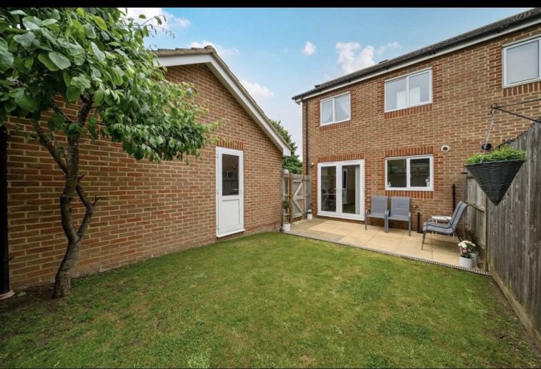

  • Isla Thompson
    December 24, 2025 at 10:53 am
    Tbh looks abit in the narrow side. As it appears to be single brick construction, which will require false wall around perimeter of the room, where insulation will be installed.
    I am a builder (not in your area) as we deal with building control and factor this within our quotes.
    You will need to apply for planning permission yourself as the garage is not attached to the property.
    Hope this info helps abit
