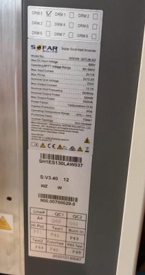

ETA Octopus didn’t mention an inverter so I assume that’s ok. The one below is what we have but I don’t know what this is!
ETA 2 I need a new inverter so this would include the cost of this.

They don’t mention a new inverter so assume the one I have is ok…
I checked and I need a new inverter. I assume the price reflects this – a new inverter and 5kwh battery.

My current inverter wouldn’t work for a battery so would need a new one. I assume this price includes that.

This is a photo of our inverter currently. I don’t really understand it to be honest. They didn’t mention a new one but did ask for details on this.

I am unclear re the inverter. I added a photo to the post which I sent to Octopus. They haven’t mentioned an inverter to me.

Oh a sofar inverter. Haven’t heard good things about them, apart from lots being replaced, if.you have access to ev and either car or charger is Compatible with a tariff like Octopus Intelligent Go, it may make sense to invstigate.what usage is and when, you may find that a new inverter and bigger battery would enable you to grid charge overnight at off peak rates, then cover baseload till solar yield takes over, then solar covers baseload and hopefully power the house untill off peak starts again !

Your inverter is not a hybrid, so you’d either need to replace it or add an extra battery inverter (or a hybrid if you’re thinking of adding more solar panels in future).
