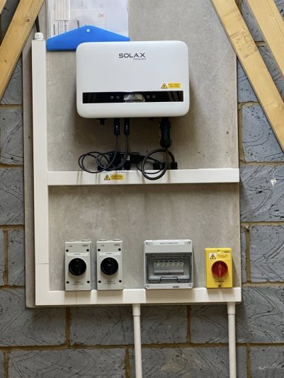

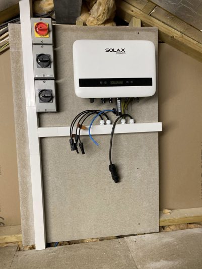

Forums Forums SOLAR FORUM UK Hi guys the first few jobs I’ve done..
  • Pete Taylor
    February 1, 2026 at 3:04 pm

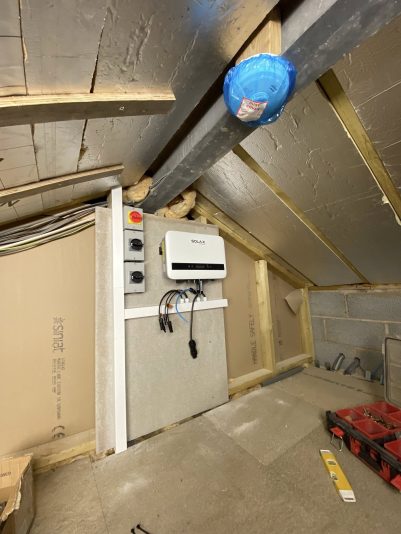

    Stop fitting them in lofts for starters.
  • Paul Moore
    February 1, 2026 at 3:05 pm
    Isn’t it just batteries that are not recommended in loft spaces?
    Does it apply to solar inverters too?
  • Paul Howson
    DC isolators aren’t needed as the inverter has an inbuilt one. MCS says if not needed don’t install them as they are a high fire risk item
  • Sam Odell
    February 1, 2026 at 3:06 pm
    Tidy work pal. Check the solax data sheet. Most day surge not required
  • Nicholas Wood
    Solar PV inverters are allowed in loft spaces. Majority of new builds have them in lofts and signed off by NHBC.
    Batteries aren’t allowed in loft spaces aswell as escape routes etc.
  • Nick Farrell
    February 1, 2026 at 3:07 pm
    I answer to your question, get some decent roofers in to do the roof work. It’s what they do, they should know the right way to install and leave the roof water tight.
    If your a spark, do what you’re trained to do. It all runs smoother and the job should then be done right.
  • James Morris
    February 1, 2026 at 3:08 pm
    Looks good
    I fit Solax so the DC isolators are required for them.
    Fire board by the looks of it too
    Only thing is, keep the AC and DC separated
    • Peter Robinson
      I used flexible conduit inside the trunking for the data.
    • James Morris
      February 1, 2026 at 3:09 pm
      no worries, it’s actually more for the panel strings and AC wiring. When ran together in the trunking it can induce voltages into the other. I was pulled on it some years ago by an assessor
  • James Adams
    Keep AC and DC segregated
  • Michael Davis
    February 1, 2026 at 3:10 pm
    Never fit the inverter or electrical components onto a flammable board ! If in the loft use the brick gable end.
    • Peter Robinson
      February 1, 2026 at 3:11 pm
      it’s not flammable, it’s cement board (hardie backer)
  • Michael Babbin
    February 1, 2026 at 3:12 pm
    If you can find a local roofer who understands solar and you can work together, it could be a mutually beneficial relationship.
