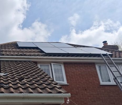

    Hi all, I am looking for help finishing a solar installation.
    Long story short.
    2022 had solar panels installed – I brought the panels, brought a roofing company in to fit.
    Got ripped off by roofing company who did a crap job.
    Had someone else to come in and help.
    I have 16 panels on 3 individual strings that all run into the garage.
    So far I am £12k in (utterly ripped off).
    I need to get someone who knows their stuff with inverters and who can help me finish. Willing to pay for the time and guidance.
    So you know I am not interested in exporting to grid – I am more interested in just minimising what I am taking from the grid.
    I have 16 panels, average net consumption around 12-15 kwh per day.
    Average typical consumption is around 1 kwh peaking to 7-8kw/h in the evenings.
    So thinking of maybe a 8-10kw inverter?
    I have no idea whether G98 applies if there is no export to grid, I know roughly what the rules are but I don’t want to end up buying the wrong inverter, not being able to get the right battery storage etc.

    You really need it designing properly
    For example 16 x 425w panels 6.8kW will happily run on a 5kW inverter if it allows for 1.5 times dc oversizing but you will only get 5kW usable power
    If you wish to minimise power from thee grid then a battery add on would be beneficial
    But all this is useless until you have applied and received your G99 approval as this will stipulate the max power to the grid allowed

    Go for a tesla power wall 3, it’s a battery with a inverter, can get up 8 strings on it it, can power the whole house, wouldn’t even feed back into grid!!
