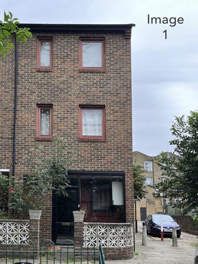

    • Image 1 is a photo of a neighbour’s house, where they seem to have put a glass front to enclose their porch

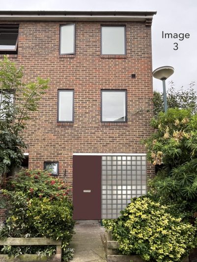

    • Image 2 is a photo of our existing front elevation

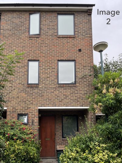

    • Image 3 is an (amateur!) mock-up of what I’m thinking with the glass blocks

    I like the glass blocks with a front door flush with them .. it looks smart… there r a few builds I’ve seen that use old wine bottles… base facing inwards neck or half bottle/cut face/ opening facing outwards … and planted up or stuffed for bug hotels or nests etc!
  • Rosie Wood
    January 31, 2025 at 5:47 pm
    I think you need building regs. How about crital/crital style, that would look fab
  • Thomas Hall
    January 31, 2025 at 5:48 pm
    You would need planning permission as it is changing the front elevation visible from the street. In terms of light, I’d say the glass would let more light in than the glass bricks. But the bricks would offer more privacy to the lobby area.
    To maximise light I would also get rid of the small bits of brick wall between the lobby and the inside, and replace with all glass.
