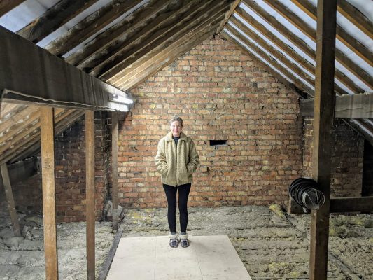

    It depends what you want to use the space for really but you’ve definitely got enough headroom

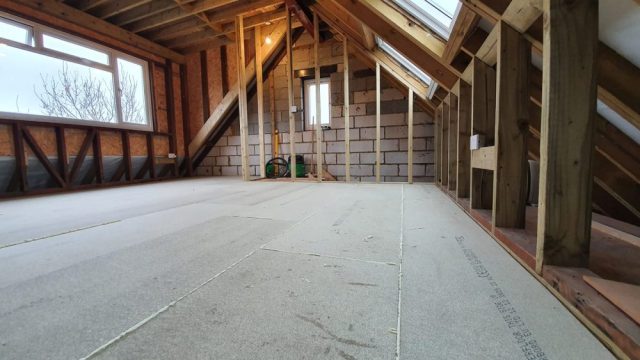

    We were the same and have changed our minds a fair few times. What did it for us was the price difference and how much head room we would have, meant we could have a good size dressing room area, and a bedroom and a seating area, I also broke it down to how much a year extra it would be and that won us over lol. Just trying to say I’m sure u made the right decision and once u see the extra space u will be pleased u did im sure.

    Your lucky to have such good height.
    I’m scraping for height in my loft only 2.3.

    If you have a high ridge, it’s good to make the most of it with a dormer, regardless of what it looks like from the outside. With a 8.5-9ft ceiling, the feeling of space is rather nice once the flat roof is on and you realise that ceiling will be so high that you cant even reach the light bulb on tiptoes.

    with that much headroom, dont really need a dormer ? save yourself the money ?
