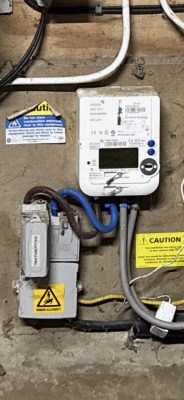

Are you on a domestic single phase supply? If so and you have a 63A incoming supply then they would only consider an application specifying a G100 compliant export limiting device, limiting to at most 15kw. If you have a 100A incoming supply then the DNO might consider your application with just the G99 compliant inverter.
are you sure they are 100a fuses ? Or it just says 100a on the fuse holders ? They came out to check mine as apparently they don’t use 100a fuses anymore due to fire/safety issues.
