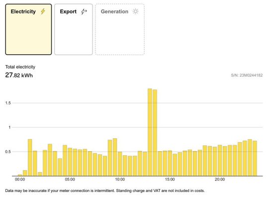

    • Roy Higgins
      March 25, 2026 at 4:55 pm
      8kWh heat pump keeping house nice and toasty. Peak in middle was legionella’s cycle for hot water.
      House empty so nothing else going on. Outside temperature varying from +2 to -5oC. North of Scotland. 1979 timber frame bungalow with 2018 double glazing and extra loft insulation. EPC B but I think that wildly optimistic.
      That gives you an idea of how much draw from a HP there should be. You’d time hot water and legionella for price dips so you can ignore that. Rest of the day, really drawing circa 1kWh continuous.
