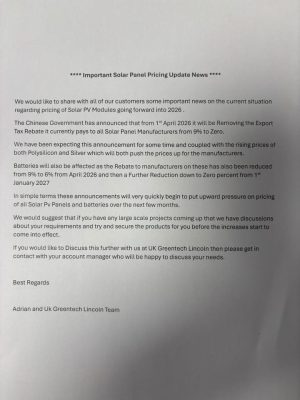

    Out of curiosity, where did you see the price increase coming and any idea why it is coming?
    • Keith Crowe
      January 30, 2026 at 11:21 am
      all installers will have received this/ similar notifications from their suppliers.
      This is one I received a couple of weeks ago.
      It’s to do with the Chinese government reducing and removing manufacturing subsidies.
      That coupled with materials costs going up and transport costs… One of my suppliers told be that they’re predicting a 20-25% increase on equipment costs over the next 6-12 Months.
    • Kevin Hann
      January 30, 2026 at 11:22 am
      I received an email as bellow,
      Market Update
      Panel Pricing in Practical Terms – January 2026
      You may have seen recent industry coverage about upcoming changes in the global solar supply chain. In short, changes to China’s export tax incentives and increased silver paste prices are already feeding through into manufacturer pricing, and this is beginning to affect panel costs across Europe, including the UK.
      What this means in practical terms is that module prices from manufacturers are increasing by around 10–20 percent for panels arriving in the UK before April, with a further increase of around 10 percent expected after April. These rises reflect wider market adjustments rather than short-term disruption.
